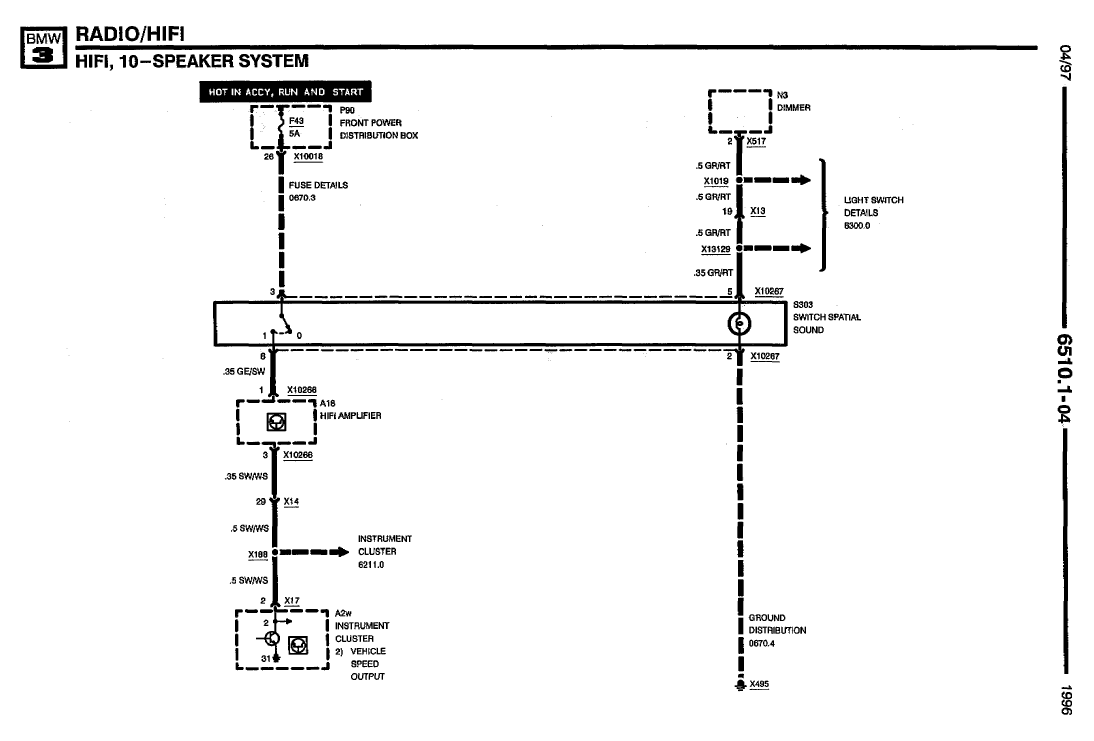

Здравейте! Сдобих се с HI-FI бутон, но без буксата. Става ли от някой друг модул буксата или си трябва неговата?

На мен ми прилича на букса 61136954554:
-YELLOW - hifi toggle, goes from switch to amp.
-BLACK/WHITE - goes from amp to speed sensor wire. I tapped into same color wire on OBC, can also be found on one of the connectors going into gauge cluster.
-VIOLET/WHITE - switched 12V power, I tapped into same color wire under dash above kick panel speaker (fan connector).
-GRAY/RED - Dimmer, I tapped into same color wire in fan connector. You could tap into same color wire in cig lighter.
-BROWN - ground. I ran it under dash to grounding point, but I guess you can use any ground in the area.
