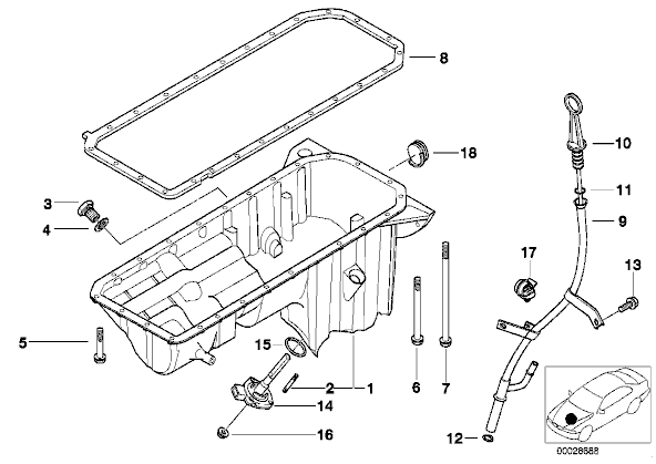

№14 на схемата
14 OIL LEVELLING SENSOR 1 12617508003 $130.57 See MH 0138861
